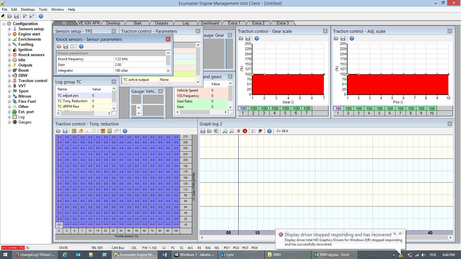

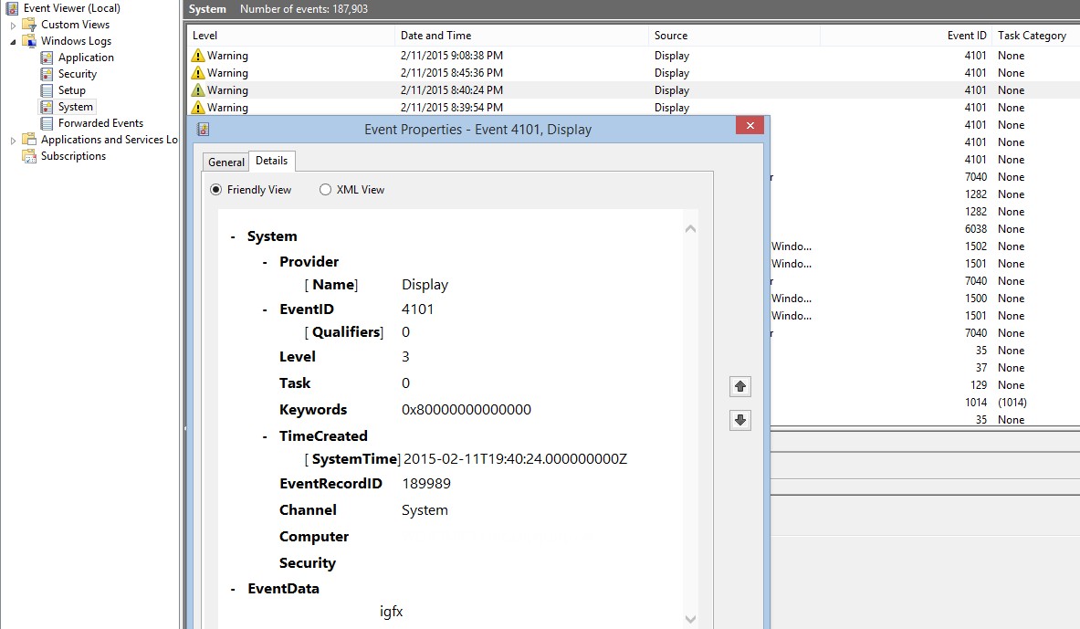

Unfortunately, this version is not stable on windows 8 Intel driver crashes , with 1.1 does not have this problem

ok now i know what happen, in older version when you close app was popup with info do you want close xxx windows
from my observation app crash if number of windows was more than 120, now i clean up one dashboard and application start fine without error but limit dropped for me to about 110 windows
in attachment desktop template that works on 1.1 and crashes on 1.102

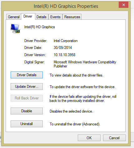

win 8.1 , i3-3220 cpu ,intel hd graphics

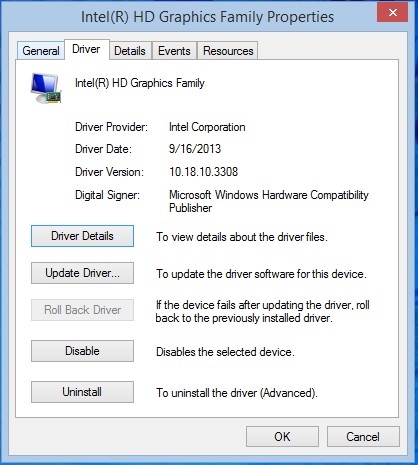

can you check what version of driver you have ?

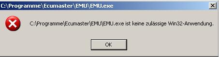

Post by eugen_troll » Thu Feb 12, 2015 12:40 pm
Dont work with Windows XP.
ecu dont work.JPG (9.92KiB)Viewed 13368 times

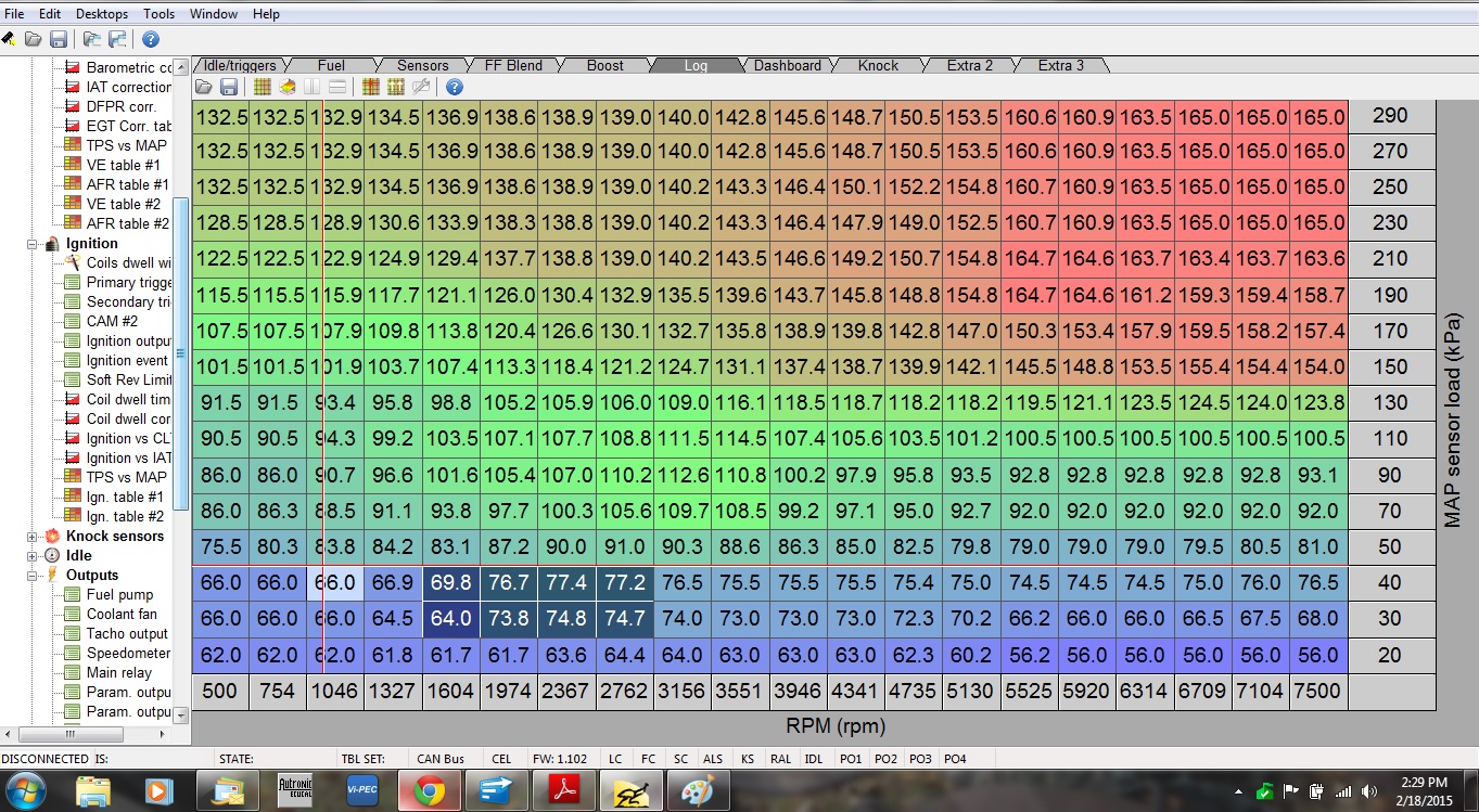

I have experienced a couple of issues. using windows 7, and have seen these issues on 2 different laptops.
I accidentally double clicked the top of the fuel map (using touchpad and I'm clumsy) and it maximized the window. Normally there is a minimize button, but it seems to have disappeared (image attached).
I'm also unable to use the '+" key to add fuel, and the shortcut seems to be correct. "-" key to remove fuel works normally.

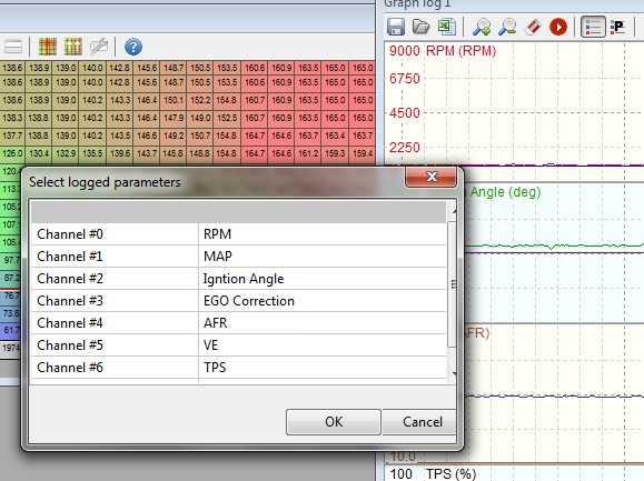

Also several windows like the log parameters window have preset size, but it is not big enough to show all options, and the scrollbar is partially covered by the window edge. I am unable to "stretch" it to a usable size. image also attached.
That's all I have seen so far, but switched back to 1.1 RC for now.

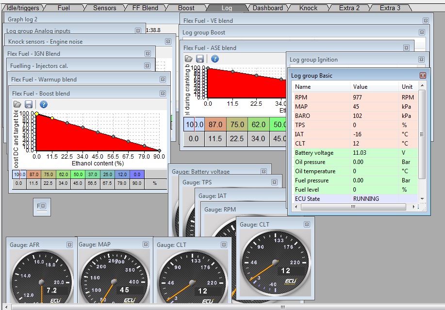

The attached pic shows all the windows I found minimized to a little tiny square, and when I stretch them out I cannot close any of them, like the close button does not exist.
ATS_Scott
Posts:113
Re: EMU SOFTWARE 1.102 EXP 1
Post by ATS_Scott » Thu Feb 19, 2015 6:53 pm
I just noticed something else about the windows I cannot close. They are on every tab. Maybe I just corrupted my desktop.XML
Post by Jadzwin » Thu Feb 19, 2015 8:44 pm
Looks strange. You can always close widnows from Windows menu.
There is a list of all open windows
