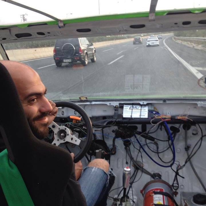

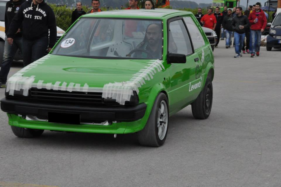

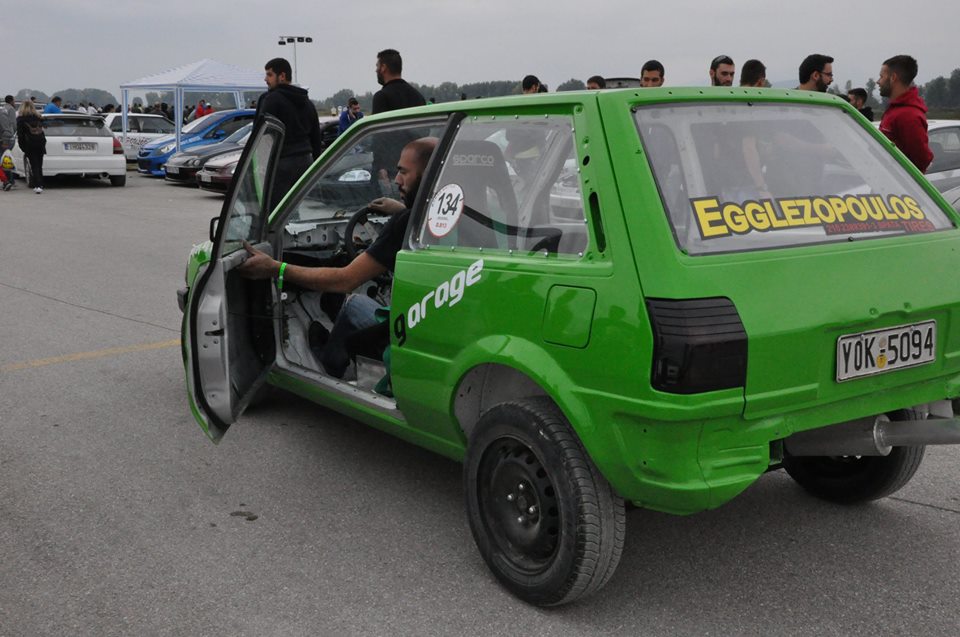

here some pics from dragster best time 1/4 mile 13.2 with afr 10:0 due to very big fuel nozzles
