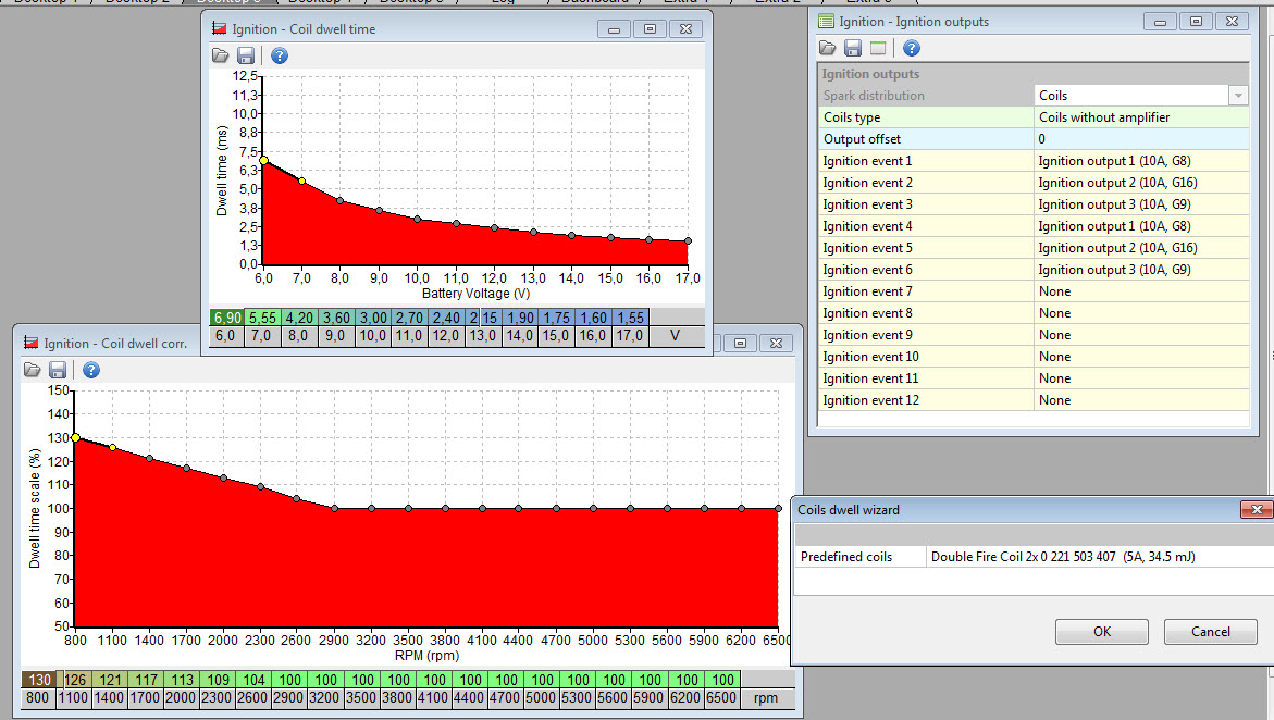

i have problems with my single coil to wasted spark conversion. Sadly my coils get too hot and i think then also damaged. Tody i tried my third ignition module and after running some seconds on all 6 zylinders i think the ignition module gets to hot and because of that damaged.
It seems that to much current is going through it.........
Can someone please look over my settings ?
Im using an VW VR6 Ignition module like this:
http://www.ebay.de/itm/ZUNDSPULE-ZUNDMO ... 1296194648
............ The dwell time is about 2.5 ms @ 12V
What could be my error ?

Post by PSI-Motor » Tue Apr 14, 2015 11:45 pm
You are using settings for a coilpack without built in igniters.

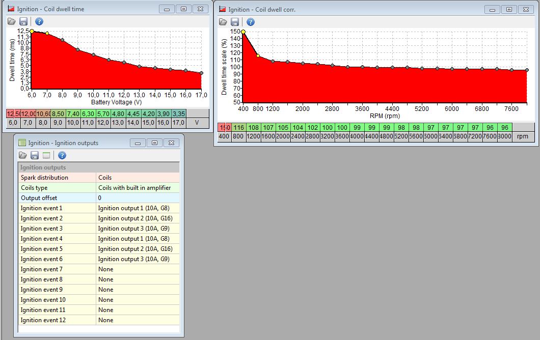

Post by Jan32 » Wed Apr 15, 2015 7:33 am
Here are my settings for the ignition module of the VR6. Blue table is dwell time from original ecu.

Jan32
Posts:191
Location:NW Germany
Re: burning coils ?
Post by Jan32 » Wed May 13, 2015 8:36 am
bmwmaster wrote:Thank you guys for Support......... :D :D
i made a first test and with the right settings the car runs well (until) now...........
Did you use my complete settings, or only switch the coil type?
