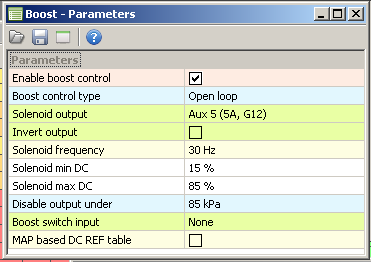

if I want to use a closed loop with a boost target, find someone learn how to configure PID control? PID control is still a mystery to me ... :(
Marab
Posts:7
Joined:Tue Oct 07, 2014 9:35 pm
Re: boost target?
Post by Marab » Thu May 12, 2016 8:28 pm
This setting is ok for the valve (MAC) supplied with EMU?
