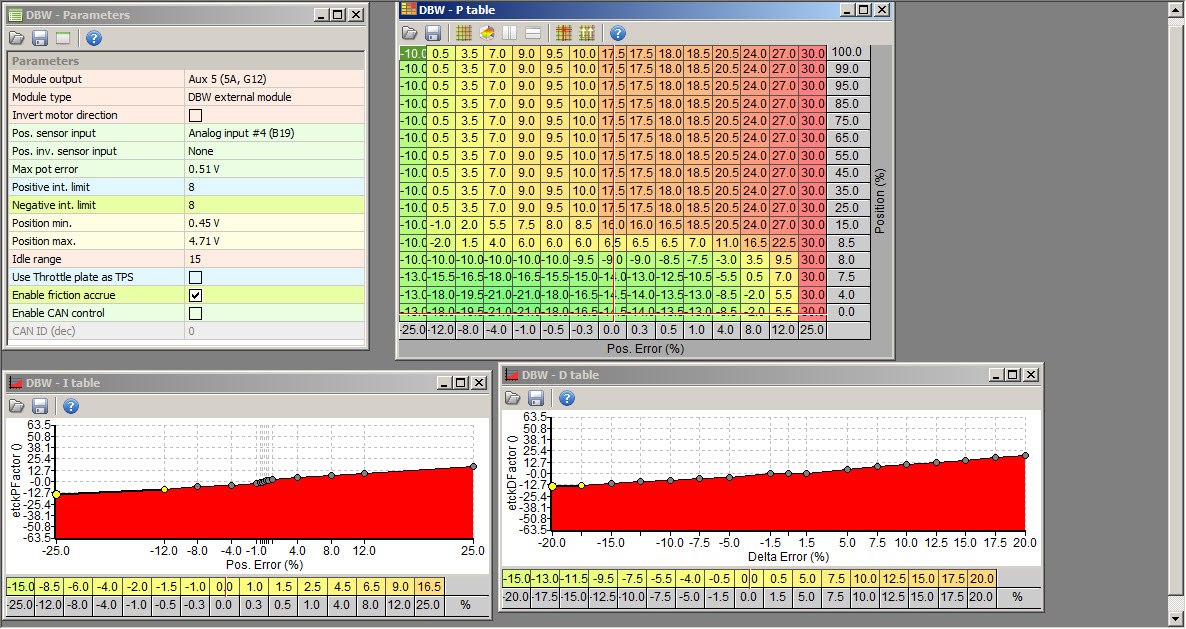

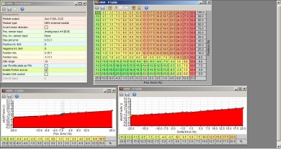

Hi all,
Kuba helped me and done the calibrations for a new electronic throttle, and I think all should share this as well, since its a very good throttle, as it's big one and could be used by many others
Throttle numbers:
1354 7 535308-02
A2C53063524
12-07-07
Germany
From searching over the internet I found that it's used on 750i BMW, on N62B48B engine, but we got if from Alpina engine, anyhow here below print screens of the configurations.
EDIT: the wiring done as the VDO throttle included in the tuning software help
