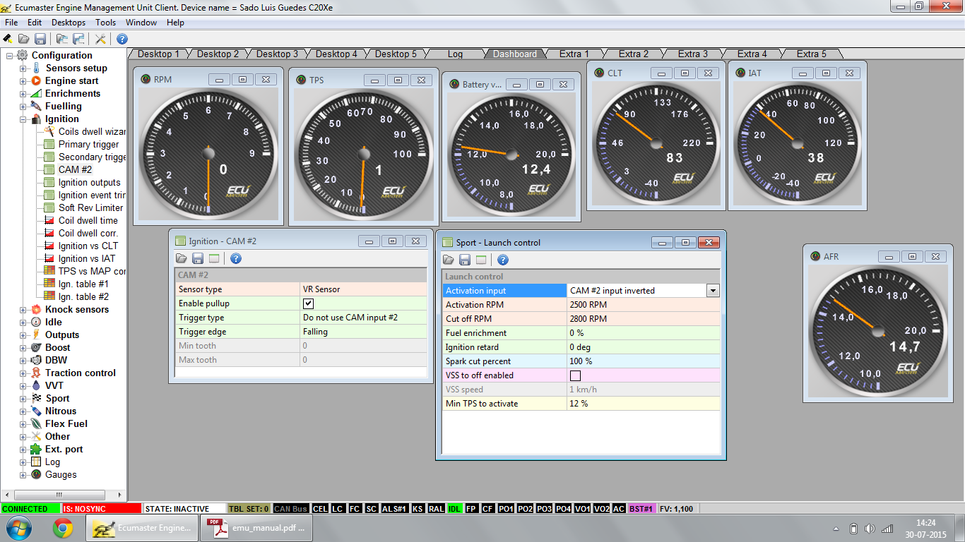

hi
please see the attached picture and see what im doing wrong..
i need to activate the lc on pin nº6 CAM 2 input
with configuration inverted, i need to switch to ground to activate.
my question is, i need to do someting more?
i switch to ground
i press the pedal above 12%
and nothing happens

Try with Hall/Optical Sensor.
