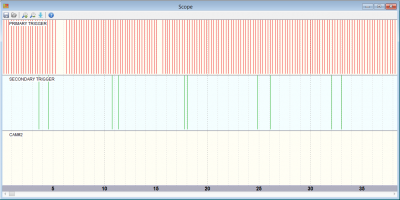

so I tried adjusting my trigger parameter to sync window with 8 (old: 4) and changed first trigger to 37 (old: 8), timing is correct and the engine runs like before. But the problem with cam sync trigger tooth falling down under 50 (under 4000rpm is allways 120) still exists.

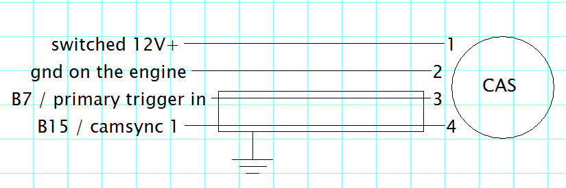

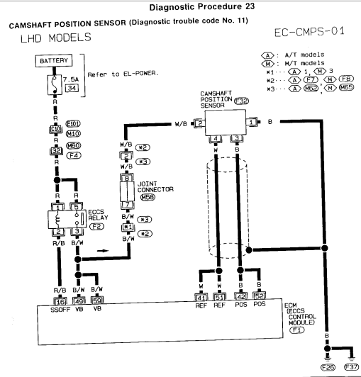

I added a drawing how I wired up my CAS, just for checking I've done that right.
greetings

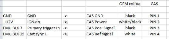

Hi thilo, just to let you know, I have used a shielded cable for the cas signal, shield grounded at ecu. Ignition cables shielded, grounded at the valve cover (valve cover grounded to the head), AND had to make a sheet metal cover for the CAS and a section of the wiring to the CAS due to problems with higher revs.
Where is your coil located, may your sensor ground from a different sensor is an antenna close to the coil?
BTW: your CAS wiring is not correct on the picture, but i assume it is correctly made... it should be like this:
CAS wiring.PNG (8.08KiB)Viewed 9771 times

Oh yes, I did a mistake with the drawing of my CAS, but it is done correct :mrgreen:

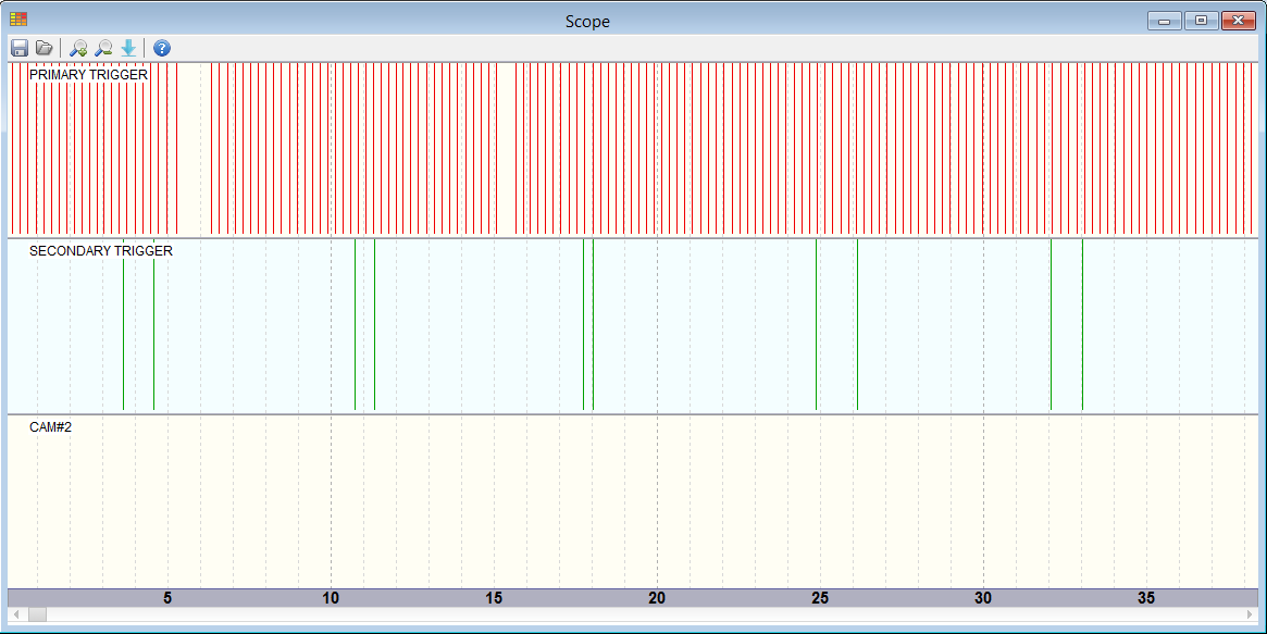

Here I have a picture of whats happening at about 4k rpm with the trigger signal.

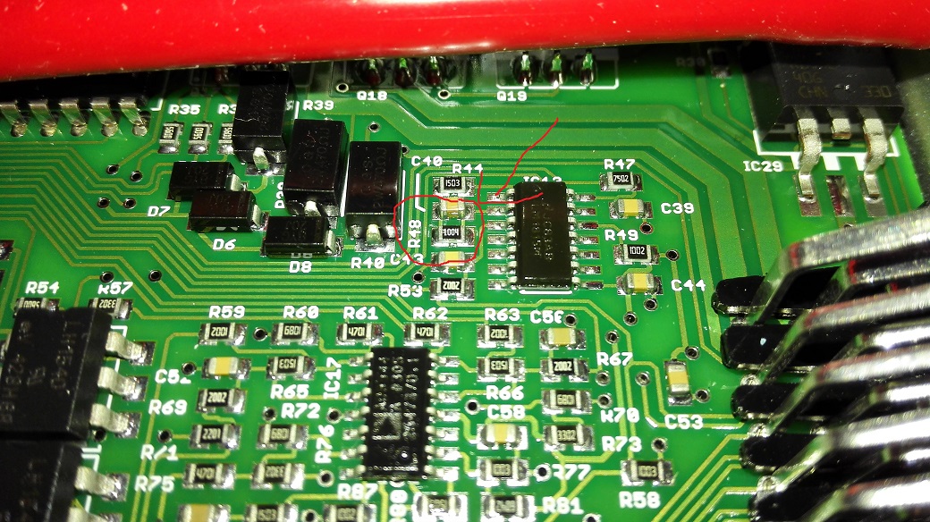

Update:

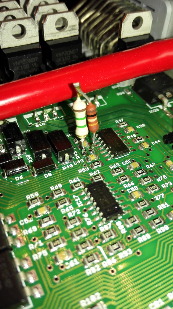

So the hardware filter consists of a resistor and a capacitor. Older ECUs have a 1 MOhm, newer a 1.6MOhm resistor. I didn't had a SMD resistor so I took two normal (1.5MOhm and 100kOhm) in series. I attached two pictures of this.
ECU still works :mrgreen: but the problem hasn't gone :(
This is my finished product. Not very nice, but works.
This ist the resistor R48.
Thilo

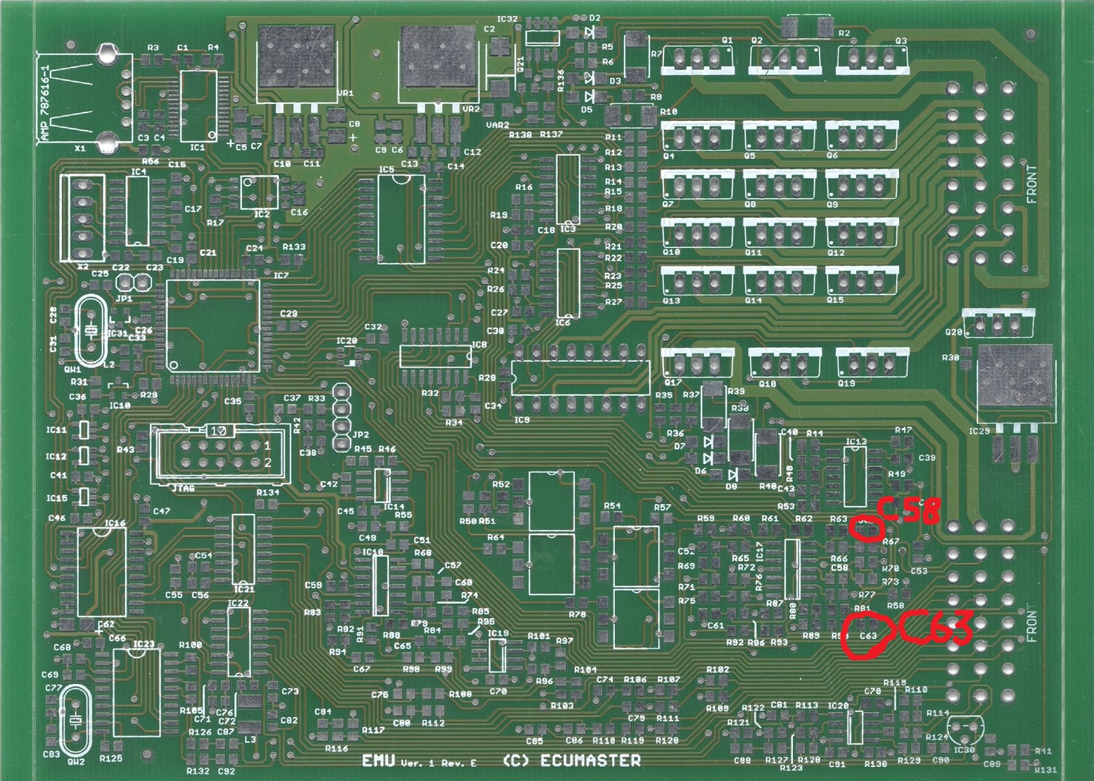

so: the problem is solved! 8-) :mrgreen:
Kisielisodd has send me another solution and this time it worked :) He said, I had to remove two capacitors (C58 and C63) which are for filtering the trigger input. I attached an image where those capacitors are marked.
Car now runs like a fucking rocket :o
Thanks for the support, great board (Y)
