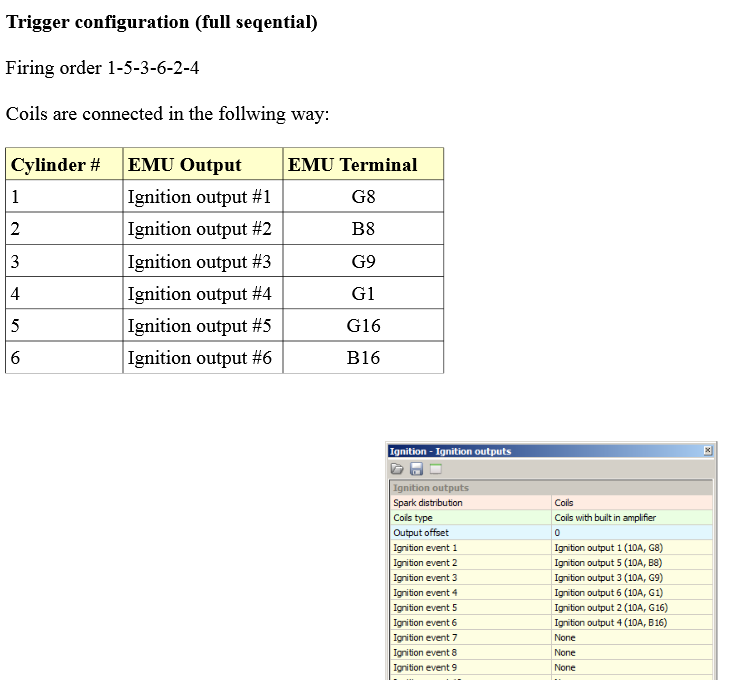

Re: 2jz wont rev at 2800!!
it actually is, the sequence has just been started in a different position to better suit the position of the cam sync signalcwtt wrote:Shouldn't your coils be fired 1-5-3-6-2-4
