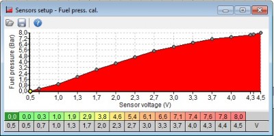

Fuel press calibration table can support only max 8 BAR graph, however my press sensor is 0.5v-0BAR 4.5v-10.34BAR
HOW I can increase table BAR scale?

Change the calibration to 0bar @ 0.5volts and 8bar and 3.7volts. Any higher readings will follow the slope and be just fine. (Double Check any other sensors, like oil pressure. I kinda remember it auto-changed all my sensors or something)
