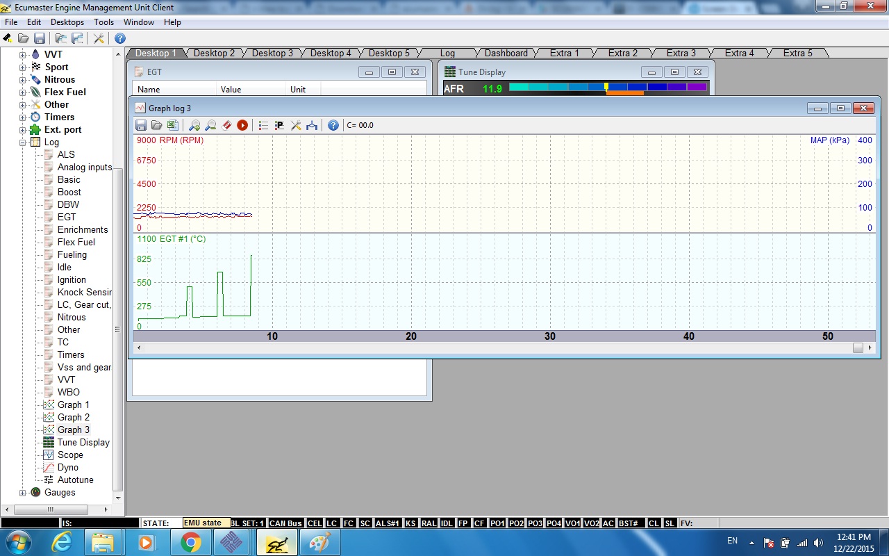

i start my c20xe turbo last day but i have big problem with EGT sensor . MY egt sensor have big fluctation. my wiring is ok. Green cable is on B1 and is crimp it with the terminal (plus soldered) . White cable is on B18 with all sensor ground cables but here this cable is not crimp direct to terminal so this can be a problem ? here is my Log from android dash.

thx i will try. For now when ignition is on and engine is off EGT work correct. but when engine is on EGT show this ....

now i try with my heat gun and EGT work perfect to 300c? but engine is not working only ignition is on .When engine is running EGT show fluctation
maybe have problem with some sensor in sensor ground B18 cable?

Yes, looks like ECU grounding problems.

for test i try to remove camshaft sensor , knock but problem is still same. i remove alternator and no effect. now only crankshaft sensor and tps is on B18.

Today i test my EGT with white cable direct to chassis ground and i think i have problem with defect EGT or EMU because problem is 95% same
this is log from this morning

Re: EGT problem and question
EGT problem is solved.
i use this ignition coils
BOSCH 0 221 604 115
and this is wiring diagram
download/file.php?id=339&mode=view
so i move pin2 - signal ground to chassis ground and now EGT works fine .
