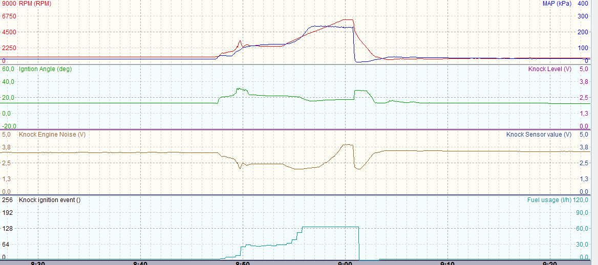

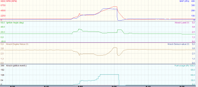

I was wondering about how a actual knock would look like in the log? If anyone has a log when an actual knock happend, i would like to se. Dosent matter what engine.
And if anyone could look at my log?

I bought 2 Bosch knock sensor with connector kit and installed them.
Still have no clue either engine knocking or not by looking at log.

I could be changing to bosch sensors, no problem, but ill need to understand the reading of them.
Reading more about this it; seems like the 2jz knock frequency will be around 6,3-6,6 kHz, and at the 2JZ sensor
is a resonat one, witch will react (resonate) at the knock vibration freqency, and will show as a much higher value than the normal engine noise during knock. However, i dont know how well these sensor work? And what voltage i should expect? Should i exepct everything over 4V etc? Should i expect lagre spikes to be knock? Are 2jz stock knock sensor useless? Does anyone have a log from their 2jz, that i could take a look at to compare to mine?
With the bosch sensors, you will se the hole vibration spectre.
This is all just from my understanding, so please correct me if i am wrong.
- 24042016.emulog
- (762.92KiB)Downloaded 121 times
Re: 2JZ knock sensors
Looking at your log, it does say that you are having knock. If it's correct i cant tell you. What settings do you have for knock sensing?paryoto.semesta wrote:Does anyone have a log from their 2jz, that i could take a look at to compare to mine?
You are running pretty lean...

I dont set anything for knock sensing (dont know how to set).
Just install knock sensors.
It is lean but it is normal if using Autronic.
I use 2 AFR meter at the same time.
