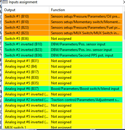

under tools "show assigned inputs" missing CAN INPUTS and the order is wrong
under BOOST BOOST/BLEND SWITCH input missing CAN ANALOG
