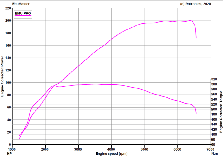

Tuned Power Output:
– Power: 200 HP
– Torque: 300 Nm
– Boost Pressure: 90 kPa (0.9 bar)
– Tuned on a dyno.
